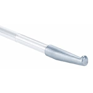

You can't pull it out with a slide hammer?
I have a slide hammer "foot" meant for pilot bushings that looks something like this: I think, made by Proto
Well I tried the welding method and the grinding method (it was taking too long and was worried about following through. I couldn't get it to come out, so I ended up finding part of a puller assembly and welding a nut on to a small piece of steel plate and welding the steel plate to the inner edge of the bearing. A few turns later I could see it starting to come out and then plop, out she came.
