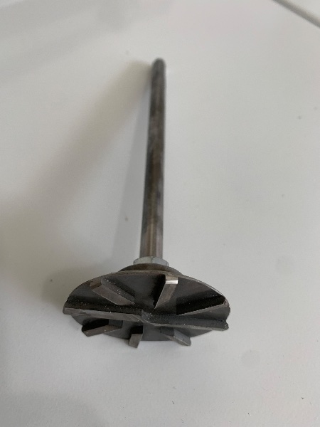

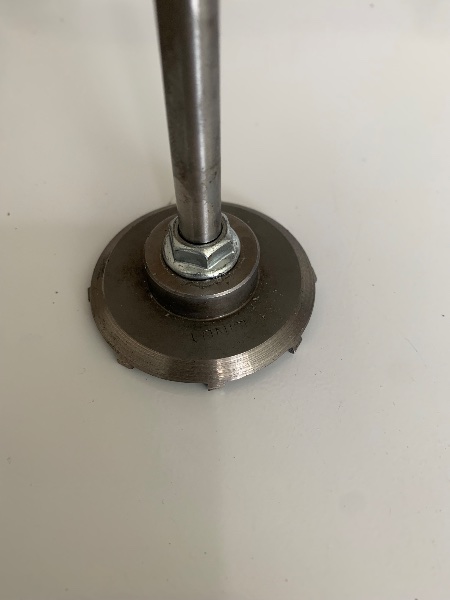

I have the Lindy tool mentioned in post 3 for 2.08" valve diameters. It worked well and it has the radial clearance built into the cutter head. If I remember correctly, they even have a rental option if you only want to do this procedure one time. They were excellent to deal with and answered my questions pretty quickly before my purchase and also after purchase.

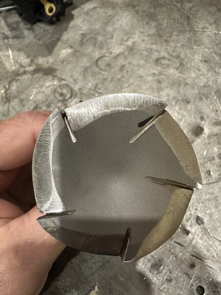

I made a fly cutter by sharpening an old LS valve I had laying around. Worked great.
