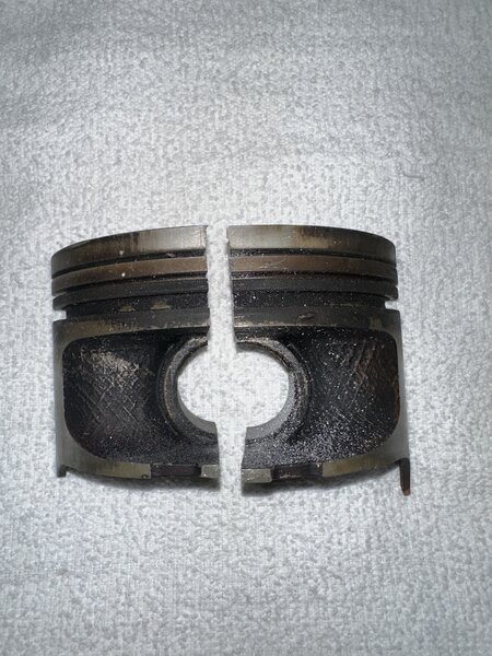

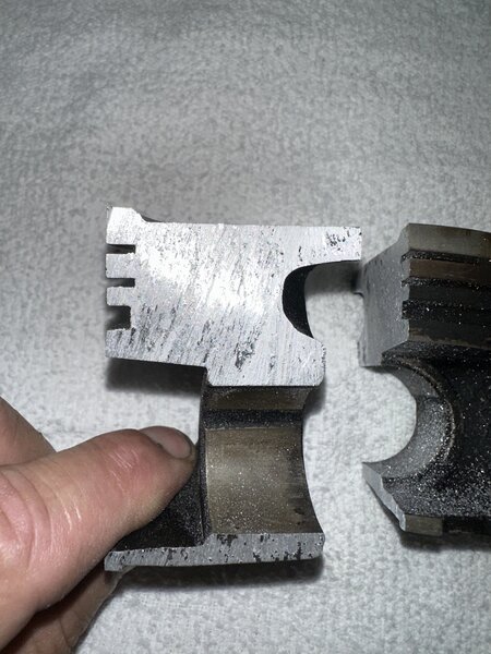

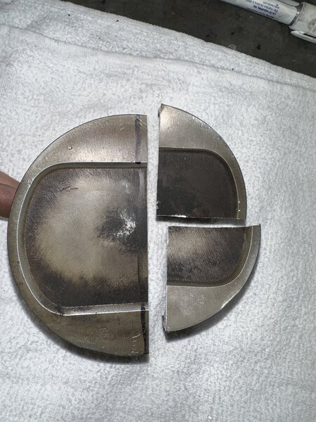

A sacrificial piston is a good idea also. Find one of the same model and cut it up so you know how thick the crown is and how deep you can cut the valve reliefs.
