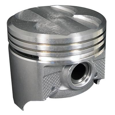

Those pistons with the huge valve reliefs look similar to the rebuilder pistons I used in a Pontiac 400. They took up 17cc.
Agree with post #76. Best idle timing is going to be 25*...or possibly more. Low compression engines have larger chamber volumes, takes the mixture longer to complete the burn.
They remind me of Pontiac pistons, too. I almost said it.

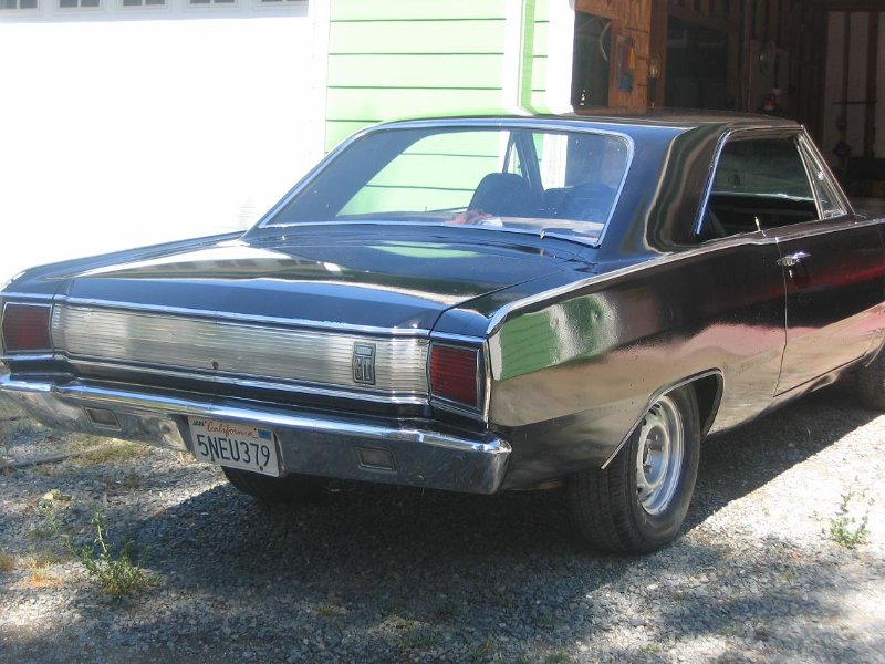

Over the Spring of this year, I built a 1990 roller 360 alongside FABO member RBConvert who built a 5.9/408.
The roller is going to go into this car:
This Dart has a late 70s 360 that runs fine but I'd like to use it in this car:
I had this idea....build this 340 and use the black Dart as a mule to break in the cam, then put some miles on it until I know the cam survived. Then pull the 340 and install the roller 360 which will stay.
