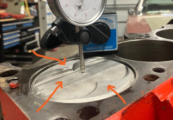

Going by the photo, the measurement isn't particularly accurate anyway because its being cc'd .004 below deck. (I got a headache!):BangHead:
So despite being almost "0" deck (block decked?), the notches must be bigger than the typical 5cc per piston + the generous bevel not found on forged pistons + the other odds & ends, results in the low compression.
Get piston top even with the deck.
Loosen the rod bolts. Push piston above deck, tap it down to even with the deck with a piece of wood.
Now do your CC check

I'm running Silvolite 1267 pistons which look similar, and they are approximately .014 above deck. Possibly 9.6:1 with the heads being decked considerably.
You must have a considerable dished piston to be that low...
UEM Silvolite 1267.030 MOPAR 340 LA Engines Flat Top Cast Pistons Set Of 8
I don't have precise tools to check the compression height of the piston but I can try and see what I get.
The flat smooth areas where the orange arrows are pointing are all within .002 of each other but I admit, my tools are not NASA precision.
The center was .004 below deck but the top and bottom edges varied. Could that be due to piston rock? I don't remember exactly but I think the top was at almost zero deck ( .002 ) and the bottom was at .005. I wonder if that could just be crude manufacturing/casting ?

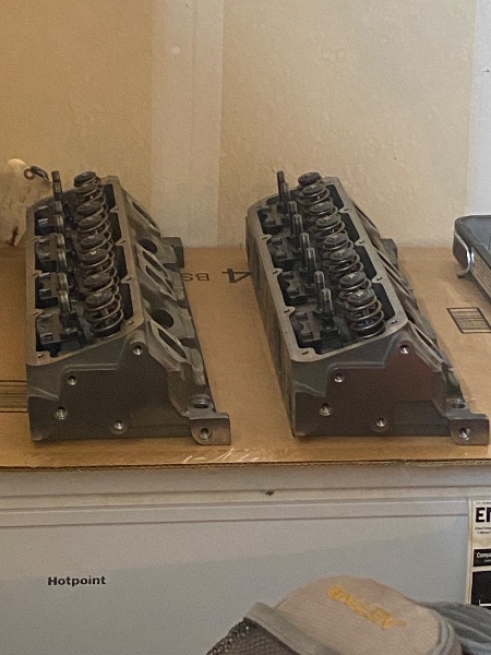

Find some closed chamber heads, if your going to stick with those pistons...
I'm just trying to stuff this one together with what I have here. I don't mind buying head gaskets but I'm not buying new pistons or different heads.
Besides the 5.2/5.9 Magnum, what factory heads had closed chambers?

Magnums. AMC lifters. Indio Machine in Ca is very good with them. These are original New Zealand EQ, and they were the best out of the box head I’ve tried. Competition Products.
