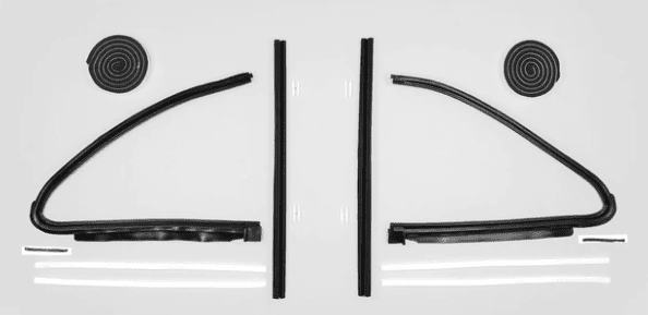

Seals and install kit are from Detroit Muscle Technologies. It is a nice kit, but very overpriced (just my humble opinion). Came to about $200 with shipping and tax. The large U shaped seals are very good quality, made by Precision. The foam strips are fine, no problems. The only issue I had is with the flocked mylar strips that act as the "hinge", along with the plastic tabs. I'll get to that shortly.

I sanded the window frames, then sealed them. Laid down the foam strips and installed the seals. The seals are pliable and flexible, so they weren't too bad to install. I did use a small, flat scraper to push the seals into the channel and then the palm of my hand to seat them all the way down. Also took a few minutes on the buffing wheel to clean up the release latch.

Next, I test fit the mylar into the "channel". The profile of the DMT mylar pieces are not the same as the originals, which does alter the final appearance a bit. Nothing major. You can see how the original slides under the chrome lip, but the DMT is kind of wedged in. Yes, the flocking has worn off, but it's still different.
