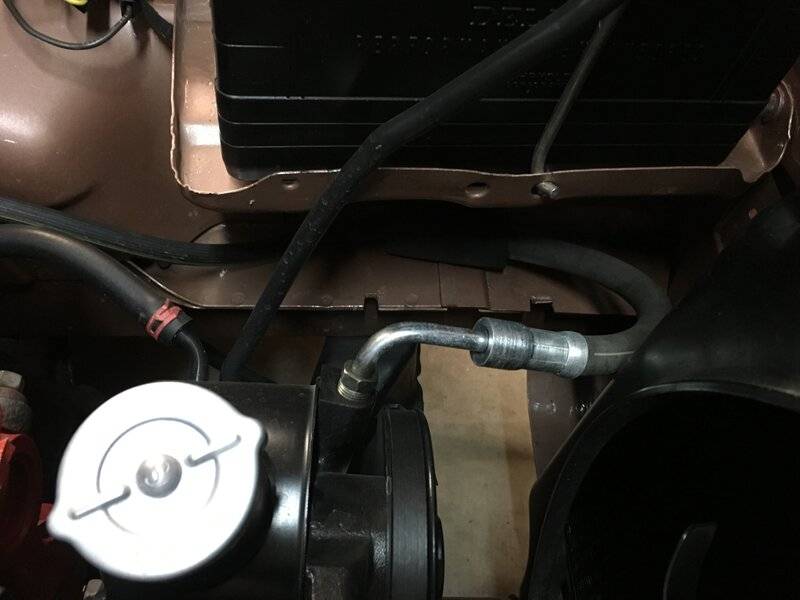

I’m changing the high pressure power steering hose on my 67 barracuda with a 273 commando engine.
The brass fitting on top of the steering gearbox that the high pressure hose connects to has a 90 degree bend fitting there. In all of my experience with multiple mopars the fitting there is usually a straight in fitting for the hose connection, not a 90.
I have found a few unique things because of the 273 commando engine, and I’m wondering if any of you guys and gals out there could sort me out on what the fitting on top of the steering box for the high pressure hose should be?
Sorry for shitty pics. Yes the psi side has 90* fitting. Fairview or Parker may mfg them?
Yes there should be a 90^ adapter (aka Hemi adapter), 67 only , 273 only (power steering wasn't available on the 383 in 67)
It should point to the side...
Hose goes forward under the battery tray and comes at the pump from the front...
(I'm pretty sure it should go around the battery tray support bracket but my electronic ignition is in the way)
