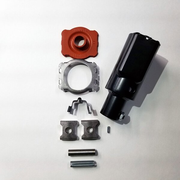

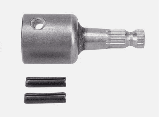

I did the power column to manual steer with the adapter worked out real nice, I see the adapters have doubled in price.
Example:

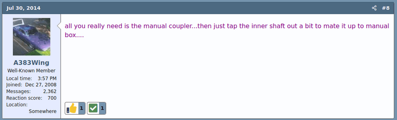

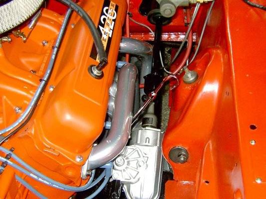

Using your own Judgement, here is a work-a-round:
i did what George showed in the box. Works fine and looks better without the adapter.
