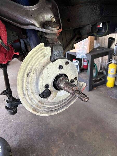

ANYONE RECOGNIZE THIS SPINDLE???
The MOPAR brake parts that were on my front wheels - parts numbers were for a 1970-73 Duster. Large single piston caliper.
**But, we've been through 2 separate Wilwood kits with that year matching, that neither fit!
**Is this a drum brake spindle????
(Yes, we are trying to identify any part numbers on it.)

Well, first of all, 1970, 71, 72, A Body disc brakes were Kelsey Hayes 4 piston calipers.
You have 1973 and up "slider" type calipers, and the gravel shield, is 1973 up, so you should have a disc brake spindle.

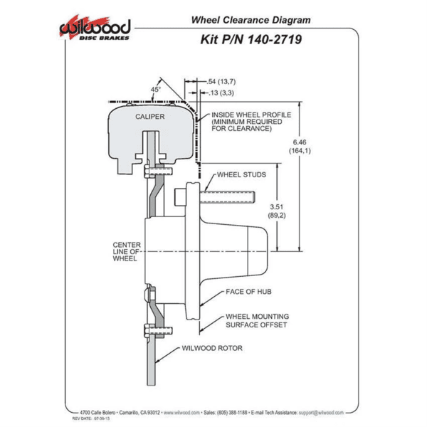

a lot of 14" aftermarket wheels don't work with stock 73~76 disc setups, even less work with aftermarket disc setups.
you'll need to measure your wheels and then consult the brake kit mfgr's wheel fitment diagrams to see if they're compatible.
here's one from wilwood as an example:

Even though my spindle is flat like a 10 inch, the mounting bolt to the upper control arm is a larger diameter than the mounting hole for a standard 10 inch MOPAR spindle!!
you have a disc brake spindle, which means it takes the large ball joint so the hole for the upper ball joint stud, as well as the lower ball joint bolts will be bigger than a drum spindle, which takes small ball joints.

the pictures above look like a standard 73-up disc brake set up so i'm wondering what you are talking about when you say its cobbled together... who have you been talking to? do they know what they are talking about? does your mechanic know what he is talking about? sounds like a bunch of misinformation being thrown around..
