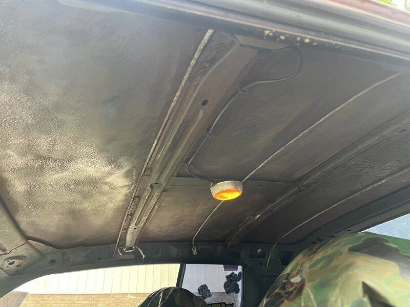

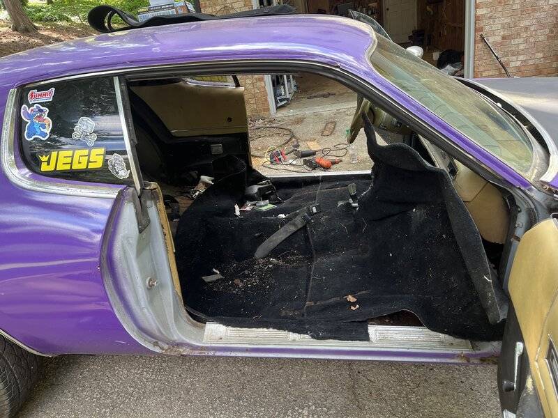

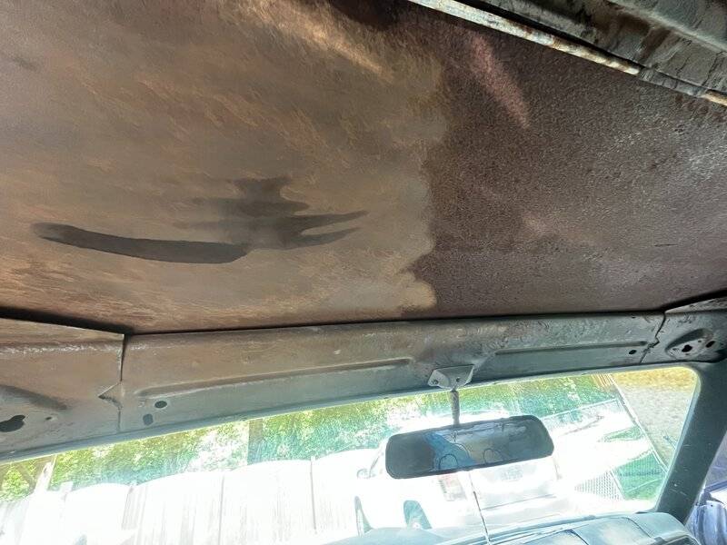

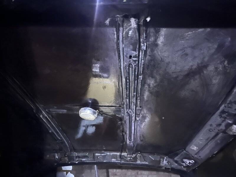

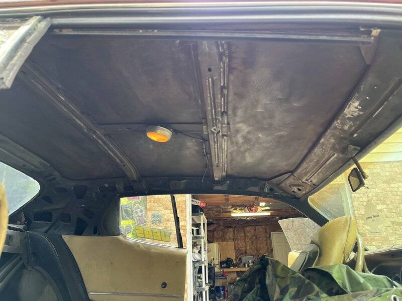

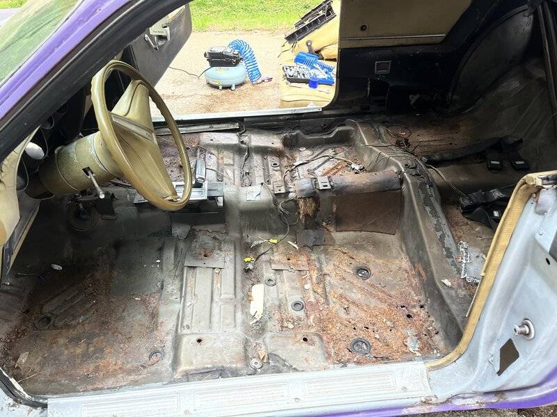

Pulled the interior today and did some rust removal
StickweldinSteve
Apr 29, 2023
63
48
Notth Carolina
wire wheeled, sanded, acid rust removal and a thorough clean and dry.I’m going to cut out my rust holes and prime everything tomorrow. I got the bright idea to use a slightly oversized hole saw on my small rust holes in flat spots and then I can use the same hole saw to cut my sheet metal ,easy fit up for butt welds.
