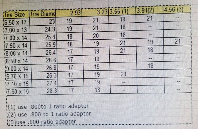

Does anyone make gears for the early 904's? I am about 5 MPH high at 75MPH...
Jim
PART #
19= dark blue 2204 358 19DB
18 = dark purple 2204 357 18DP
17 = orange 2204 356 17O
21 = grey 2204 360 21GR
20 = green 2204 35920G
PART #
I have been trying to find that table for these cars and have not had any luck... thank you so much. I know I have a grey in there so looks like I need a green or blue.
