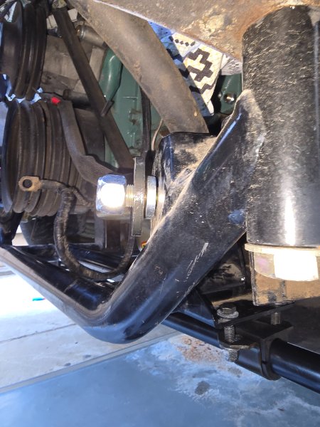

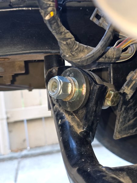

Hello i was wondering if I installed this properly. Is the hump supposed to be facing down or up because I got it facing upwards and it hits the k frame. I cant find any posts of people installing the firm feel on the k frame. I got a 67 dart. Are these parts that came with the sway bar supposed to go onto the k frame as well and what is the small piece supposed to go?. The part where it says firm feel doesnt fit onto the k frame. The nut is to big it hits the end. to Also the is the strut rods supposed to be with the big washer first or the small washers first? Thank you for the feedback I just want to makw sure before I button it all up

Sweet thank you but my problem is the spacer will dig into the frame well atleast the bolts will. I could still bolt it on but its gonna be touching and it will scrape metal off for the top bolt. I have qa1 lower control arms. Would you install it how it is now or use the extra piece for the shock mount bolt? I can't find anyone with the qa1 k frame and firm feel sway bar

Well, any time you combine aftermarket parts from different manufacturers, there's bound to be little glitches. If you need to shave the Firm Feel spacers a little to get them to play nice on the QA1 K frame, that's not out of the ordinary.

Yea you answered my question I think I will shave a bit for but yea the lower control arms comes with tabs. What about the tie rods is the washer supposed to be that way?

You're probably not going to find anyone with the FirmFeel sway bar and a QA1 K frame, because QA1 makes it's own sway bar specifically for that K frame and tells everyone that nothing else will fit with it. You will likely have to modify the mounting hardware to make the '73+ Firm Feel sway bar fit with the K frame, if it will work at all.

You're probably on your own on that one, the spacers were designed for the stock K frame, not the QA1 tubular K frame. So even if you had instructions they wouldn't work for what you're using the parts for. With the QA1 tubular K frame it would probably have been best to use the QA1 sway bar and strut rods.

The strut rod spacer set up was probably intended for the stock K frame. Based on the pictures, I'd say none of them are correct. The smaller spacer is likely meant to fit into the K frame and go between the two larger spacers to keep the strut rod mount centered. But based on your pictures it looks like the small spacer is still too large to fit into the hole in the tubular K. So you're probably stuck just using the two larger spacers.
The only possible problem I see with that is that if the inner mounting block doesn't have a shoulder on it that fits into hole the K frame. If that's the case, it might be possible for the strut rod mount to not be centered in the K frame mount, or to move later so it isn't. But I don't know which strut rods you have there or what the other side of the strut rod mount looks like. You might need to have that smaller spacer turned down so it fits into the hole in the K frame and between the strut rod mount and the outer spacer.
