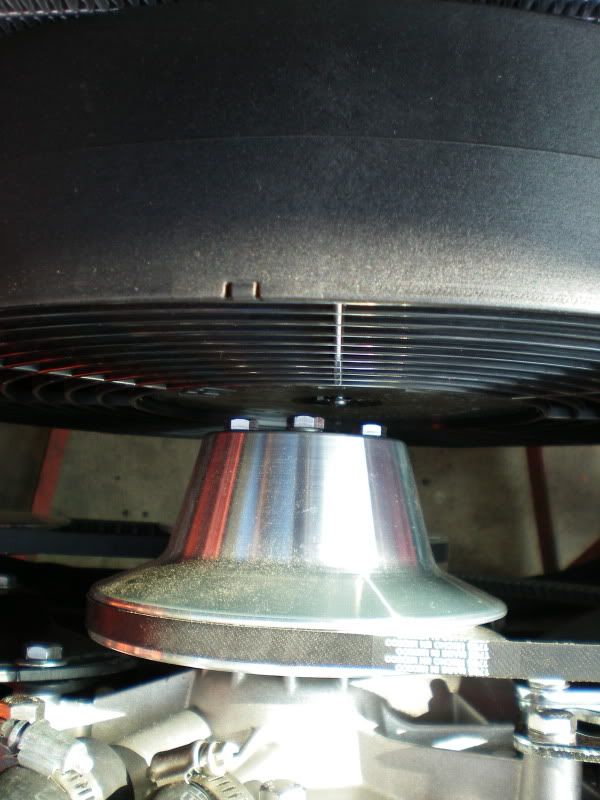

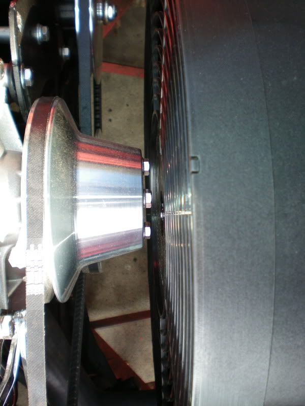

We went with a Summit 2 core aluminum Radiator, March performance pulleys, and the only electric fan that would fit. The radiator is 26 inches, the fan is a Derale 17 inch electric fan. We had no room with the 360 for a fan shroud.
Hope this helps....

Thanks....Tight fit huh. What's the CFM on the fan? I have a new 28inch 2 core/copper and heat up to 210 in traffic. I would hate to make these changes and still heat up. By the way, I'm in Yorba Linda.
