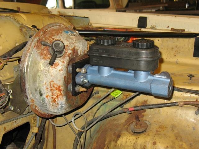

A brand new aluminum power disk master cylinder was found on the same New Yorker as the rear drums so it followed me home from the yard too. I wish I had the forethought to yank the booster at the same time. For it to mount to my '74 booster a 2 - 4 bolt adapter (Mancinci Racing) was needed. Next project is to get the booster rebuilt by "Booster Dewey" across the river from me in Portland, OR.
