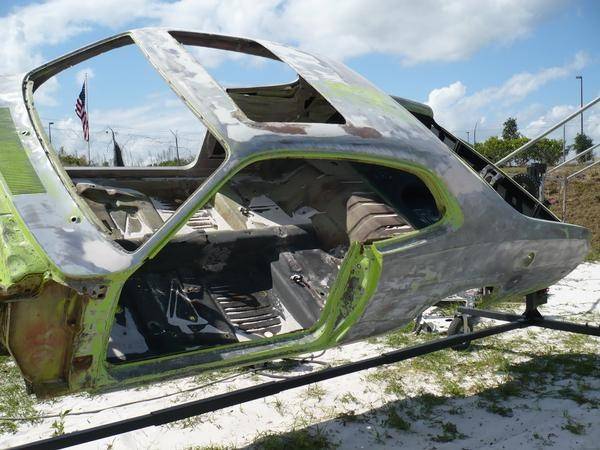

Well as of the last uploaded pictures, All rust has been cut out and replaced with new metal. All factory seams were filled with SEM Panel Bond. The entire shell was treated with metal prep then primed with self etching primer and finally epoxy primer. The car is now off the rotisserie for body work and is getting skim coated with a light coat of evercoat quantum 1 and metal glaze to remove any waves. I want this car as straight as a dart... lol, literally. Only the best materials are used, there is over $1500 worth of materials in this car as of these pictures.
Enjoy the pics!!!

Actually this IS my first restoration. Im 21 and just got out of auto body school. Just payed attention and took notes haha.... I worked at a couple hot rod shops and quickly found out that many many people dont know what the heck they are doing and literally destroying cars so I decided to do my own thing. This is my first customers car. I dont cut any corners when it comes to quality so its either my way or no way :)
