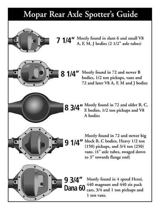

See which diff you have,mrmopartech

Which diff do you have in there,7 1/4,8 1/4,8 3/4.Did you check the picture chart of diffs on the site?mrmopartech
Looks like i have the 7 1/4 because i count 9 holes, and my car is from 1965 and all. Looks like they gave me a gasket for a 8 1/4th. Thank you for the picture.. that was perfect!
