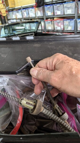

My cable does not separate from the ball end. Must be stuck somewhere. I tried pulling it really hard nothing. Ill have to dig deeper on my darn back…
It should.
Paint?
Got so hot it melted the led "ball" a bit?
Try a knife or small screwdriver to separate the "ball" from the spring
Unless the spring is really compressed it's really not too stiff to move by hand.
It should.
Paint?
Ball is not fused to the spring. The cable appears stuck somewhere.
If you have to buy a new cable, DO NOT BUY A NAPA CABLE. They do not fit the backing plate hole very well. I found after trying 4 different cables, the advance cables are really good. But there are other good ones out there also. And i work at Napa.
I was able to break the cable free without damaging it. It was stuck and tight and I was able to push and pull it through the sheith until it was “relatively” smooth. Now it should be a snap.
Good, but if u don’t have it totally free it will stick on the brake on that side so don’t use your E brake till u get it fixed. Graphite in the little tube works great. Put some in from each end. Best to have the cable unhooked from each end.
I don't remember where I saw it but someone made an adapter of some type that went over the cable and and end and they were able to pump some type of lube into the sheathing
