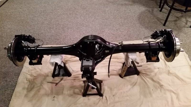

Here's mine.
Done by hand using pretty close to the same procedure as Garrett Ellison suggested. POR 15 is fantastic to use and leaves a great finish even when brushed on as I did.
Great job! Rustoleum on top of extend rust proofer gives a similar finish, and the more elbow grease and determination, the better. The blue $30 plus angle grinders from harbor freight are adequate, just take your time and don’t crowd the machine. If it heats up and trips, go ahead and clean and prime what you’ve done during the cool-off, plan on using the better part of a day. The cleaner it is before priming, the longer it will last.

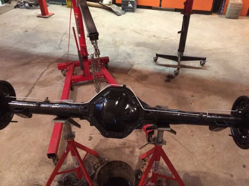

Here's mine.
View attachment 1715281162 View attachment 1715281163
Thanks guys, looks like a little time will be required to get the results you guys got. No problem, it's a long winter up here. I've used POR 15 a few times so far. Did you do the backing plates with it also? What did use as a top coat over the POR 15? Thanks, Woody
