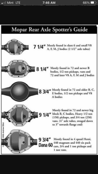

I am almost certain it is a 7.25. I can get some pictures to post at lunch. It is a 9 bolt cover that is more offset than nearly round and 2.5" axle tube. If I remember correctly the 8.25 has a 10 bolt pattern and 3" tubes
I think you missed my edit. If it's small pattern, it ain't an 8 1/4.

So apparently I dreamed measuring the 5x 4" BP when I bought the car last year. I just measured it again and it is the BBP. I've attached pictures of the rear end.
Yep, 7 1/4 BBP is what it should be.
