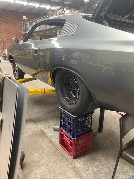

Ok so some people going to look at me weird and think why! I want to adjust the quarter side of my tub!! So i can bring the wheel further out to fill the guards.
So the issue with the A body is not the size of the tub but the design.
I will be running a 275 on a 8.5 inch rim with 3 inch back space with leaf half inch offsets. Diff shortened accordingly.
I dont want a jacked up look and also dont want to have my wheel set into the car. So traditional tub work will not fix this problem, stretching tub is not the answer if going towards centre of car.
If not adjusting outer tub the wheel has to be set in as the tub steps in after about an inch of travel. You can see what i refer to in the pic with my quarter removed.
From inside to outside of tub you have 300mm but as soon as you go up an inch lose half an inch

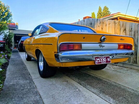

If you do not fix this issue this is the look you will get. Doesnt look correct i want my wheel further out to fill the quarter. 2 of my mates have an Australian A body and one had a full floating folded diff built to discover it looks like *** and starting again. Funnily enough i rang him to talk about my issue and he told me earlier in the week diff builder rang him with same issue. As he only tubbed the inner.
Has anyone had a crack at playing about with the stock tub and how? Thinking can cut it and press the step out to make more space on the quarter side and re weld. I dont want to remove tubs and install a full tub i hope can just adjust and if anyone had any luck.

If you've got the quarter off it will be a lot easier!
I did this on my Duster with the approach of doing it as a "reverse mini-tub". I replaced the whole outer section of the wheel well. The "bump" in the outer wheelhouse is the first issue people encounter and you can just hammer that part out for more clearance. But even doing that, you still have the angle on the outer wheelhouse, and a big gap between the quarter and wheelhouse. Here's a picture of the outer wheelhouse and the quarter. You can get rid of some of the bump, but, you can't get it anywhere near the quarter with just a hammer...
From the inside. You can minimize that "bump", but you're not gonna gain all that much without moving a bunch of metal, which you won't be able to do with just a hammer. You can see the bump where my tires started to rub the undercoating after I added my rear disk brakes. The red line is the section I took out
You can see here the bottom of the C-pillar that welds to the wheelhouse, this is why you're not going to be able to get ride of the angle, it's built into the C-pillar.
I reshaped the whole bottom of the C-pillar, then built a new outer wheelhouse. I managed it with the quarters still on, it would be a ton easier with the quarter off. This is what the end result looked like, but you can see the entire operation where I opened everything up, reshaped the bottom flange on the C-pillar, pushed out the quarter sheet metal to gain some additional room, and then replaced the the offending section of the outer wheelhouse. Outer wall of the wheelhouse is now vertical, the 295/40/18's fit with plenty of room to spare, and the car has settled a bit lower since the last shot was taken. Could probably fit a 315 now with the 1/2" offset and wheelhouse and quarter lip work. The link below the pictures should take you to my build thread and the whole process, with a lot more pictures.
