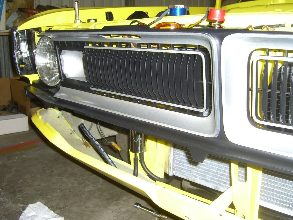

great advice from the forum. It is not perfect but much better than I expected considering I have a bad case of ADHD. Could not of done it without you guys...
Thanks much,
Craig
BTW...
I used SEM Gloss Black and Metallic Finish from Rust-oleum with a Matte Finish from Krylon.
Thanks again for all your help...
