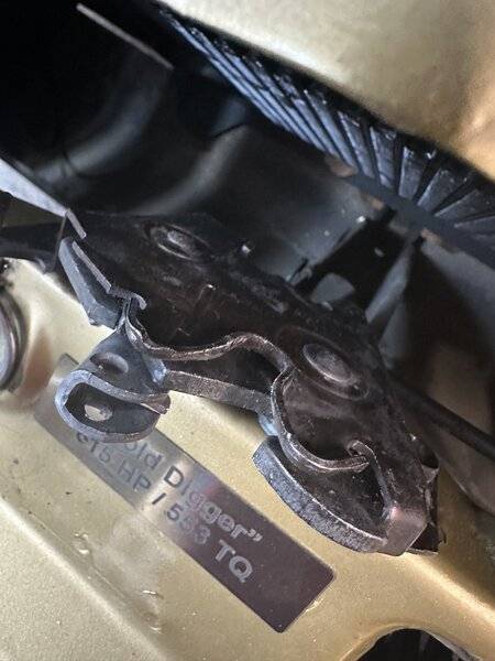

EDIT - I think I actually used a Volare hood latch! There's a part that sticks up (upper right of this picture) I will probably trim off since it's not really used
