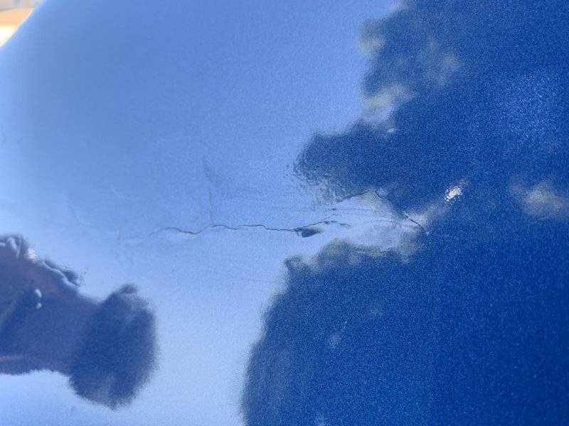

My 71 Scamp has had some rust damage repaired with Bondo in several locations on the car. I’m not really worried about most of them, but the C pillar repair is beginning to crack and bubble just a bit.
I have a vinyl top I plan to have installed, and I don’t want to trap this underneath. I have zero bodywork experience, is this something that’s approachable by someone with no Bondo experience?
I would say if it’s cracking it may be worse than it looks. looks like it’s on the joint where the quarter meets the roof. These were originally leaded in. If it were mine and putting a vinyl top on, I would sand the Bondo away until I found clean metal. Clean and neutralize any rust, seal it and use All Metal (similar time Bondo but aluminum based). I just repaired those areas on my super bee.

Most likely there is rust underneath the bondo. That will probably require a patch of some sort and a lot of paint work. Under no circumstance
install a vinyl top over that, that would only make it worse. It may have the same issues on the other side as well.
Yeah, that’s what I was afraid of. The previous owner took a lot of shortcuts that I missed (not knowing what to look for) but noticed after owning the car for a bit. The thought of ripping into the paint is pretty intimidating, but I know it has to be done.
There’s a lot more rust there than you think. That picture of the underside clearly shows bondo coming through holes in the metal. And that picture is showing the base of the C pillar at the very end, which is part of the quarter. So you have two panels involved in multiple places.

It's impossible for us to tell from a few pictures. But if the kind of work they did at the roof/quarter seam is indicative of the work they did everywhere else, then the only way to be completely sure is to take it completely back to metal. If there's rust through where you've shown in the pictures, there's very likely rust through in other places. And since they covered it up once, you can probably bet that's what they did everywhere else.
But like I said, a couple of pictures on the internet don't exactly give us a complete view of what you have going on. My concern would be that what you see at the roof seam is just the tip of the iceberg.
