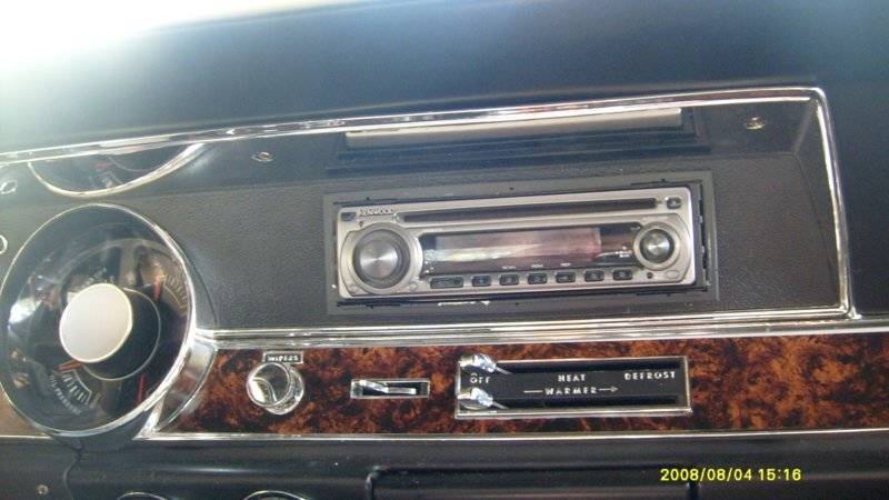

Here's where I ended up.
Gutted original radio, bent some new side pieces, I had to tack weld the wonder bars and installed an outofsight Bluetooth receiver.
Does anyone know what these electrical connectors are called and/or where to buy them? Found an open female connector for the yellow constant wire, but I need a male to hook up to it.
I wouldn't trade my D.I.N. friendly rally panel for anything else but... it isn't easy or cheap either.
