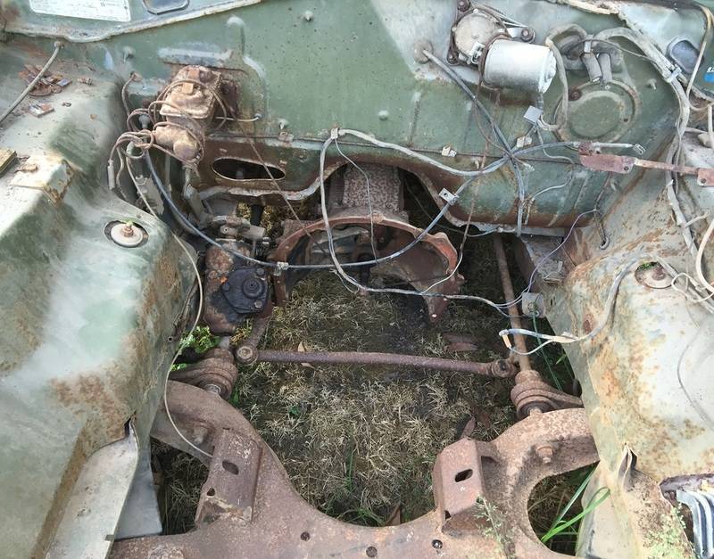

Given the RHD steering box issue will severely limit me for off-the-shelf fitment of most headers with the outlet coming out close to the steering box, I was looking at center dump but threads on here say they are more suited to truck applications. Is this due to clearance ?

Unless there is company from down under or England making headers for these RHD's, shorty or custom fab may be it for you.
I don't know what kind of clearance you have. I'm sure someone from down under has a answer to this.

To make it a little clearer in relation to space, I have taken a couple of photos of my parts car (which is obviously missing the engine in the photo, but does have most of the steering connected (except the column, which was pulled), and shows the space I have in terms of length.
