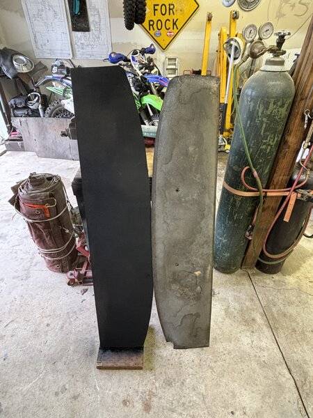

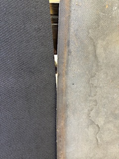

My package tray was disintegrating. This pressboard from Home Depot rough side out looks close enough for the girls I go with.

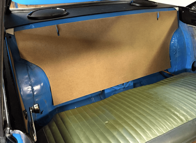

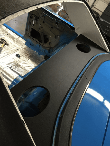

That's what I did on my Dart for the package tray and rear divider behind the back seat and also the spare tire cover.

I traced out my existing package tray on the smooth side of the pressboard. Cut it out oversized because the original’s edges were curled in. Test fit and trimmed as needed with a cordless jigsaw. When I was happy with the fit I spray painted the whole thing flat black. The rough side is pretty close to the texture of the original.
