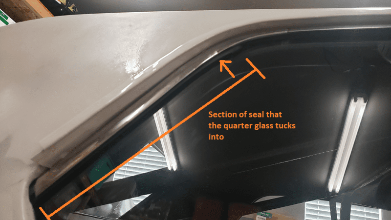

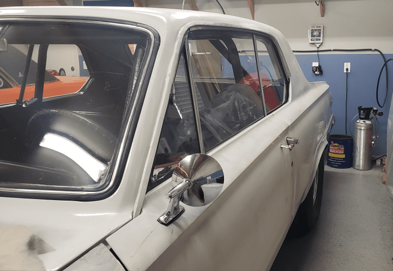

I just installed that piece on my '66 a couple months ago. It wasn't too bad at all. I started at the front by screwing in the front screw and worked my way back. I also glued down the front piece that hangs out of the channel where the front screw is. I used a plastic trim tool to push both sides of the seal (inner and outer) all the way into the channel. You'll know once it's seated all of the way. There's a spot on towards the rear around where it starts to bend down that flaps in front of the quarter window. It's hard to explain, but you'll know when you see it. I'm happy to take any photos you need.

Can you send a photo with the glass down looking into the track with seal installed and one with the glass up and against or into the seal. Still not sure if the glass just seats against the seal or tucks into it. Also does the flat back of the gasket push all the way up into the trim piece and butt against it.
I'll snap a couple photos in a bit.
Yes, the flat part of the seal pushes all of the way into the channel and bottoms out against that trim channel.
Does the glass seat against the rubber or tuck into it. When l install the gasket the slot becomes pinched closed
Rear quarter glass rolls up into the slot, door glass closes against the outside of the seal. Otherwise you'd need auto drop glass like a new challenger to open the doors.

Just roll the quarter glass up and if need be hold the slot open to make sure it doesn't get caught and folded over and above the glass edge. Then roll the door glass fully up and close the door. You have to watch it closely until everything takes it's "set".
If that's the case then the '66 Dart is the oddball in the Mopar fleet. I have 6 cars from '64 to 70 sitting in front of me. On everyone of them the quarter glass is in the slot for the glass' entire length, then the door glass sits against it from there forward.
