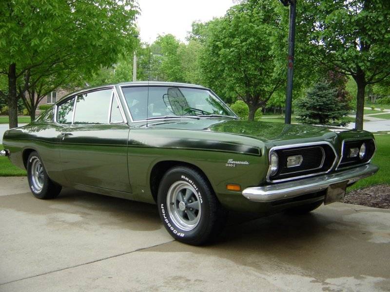

Thanks, @abdywgn, I swear I have been a member for a while, just have spent a bit more time on the e-body lately.
Here's a pick of the a-body - #s matching 69 Barracuda, 340-S Fastback. My father and I built it ~20 years ago when I was in high school. I recently picked up a 74 cuda and we swapped in a 392/8-speed. After driving that, we decided we were finished with carburetors.
