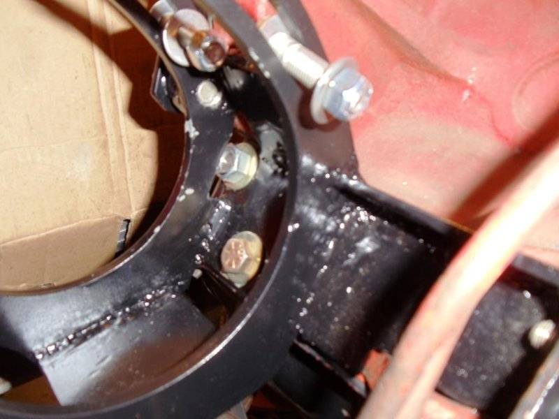

Search the long post about AC compressor options for a slant. I haven't seen anyone leverage RV2 brackets. Since my 64 Valiant doesn't have power steering, I used that mounting pad for custom Sanden brackets. I started w/ universal ones and had to cut and weld. I also have Sanden brackets from a ~77 Volare which would also give me a Saginaw p.s. pump if I change to that later. Clearance is only ~1" to the battery. Likely more in a wider 1967+ car. But, narrower batteries are becoming common and cheap and may become even small Li ones soon.

Photos of my custom bracket. You can find many other slant Sanden brackets in the post of a few years ago.
