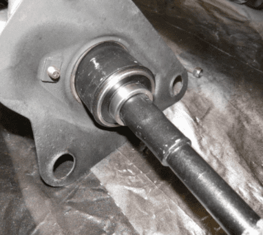

My first suggestion would be to pick up a SER205-16 bearing. You can find them for around $10.
SER205-16 insert ball bearing 1 inch shaft
It fits very nicely in the column jacket and stabilizes the steering shaft. You may have to hone the column jacket a bit or remove some paint from the shaft.

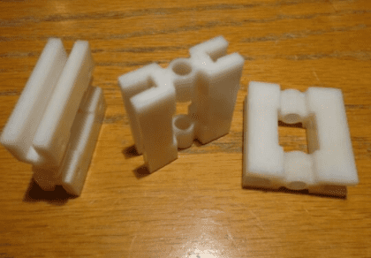

I don't know if your car uses these spacers, but it might be a good idea to replace them... they go on the column mounting bracket. Pic below is on my 70 Duster.
