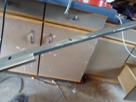

Ok, cool. Made some progress, least how things will look.
I took a 1"x1" square tube. Cut one of the cornes, and split the tube.
ended up with a 1"x3/16" "L".
3/16" is the spacing on the chrome lip that holds the weather stripping.
I then took the orignal weather stripping strip, split it down the middle.
I left the backside/interior side of the stock strip and used it to hold the back of the weather strip, and my new pieace will hold the front.
I will end up getting a shop to bend me the metal i need for this, so its precise and then I will weld it to the car, grind, feather, bondo, lead, whatever and smooth it in. So that you would never notice it was added on.
Just a trial pic, tell me what you think.
Hope this helps someone out on their project....I think this is a better solution then using these magic weather stripping clips I hear about...as this looks more secure, and I feel will tidy the look up as far as gaps and what not.

Update. Been at a stand still lately, money and other things going on.
Friday I am supposed to be picking up some sheet metal from a shop in town, they are also going to be cutting me enough strips bent into a "L" for me to use.
I ordered it 3"x1/4", this will fill the gap of the weather stripping, then I am gonna take the 3" and tie it directly into the roof skin. I will also end up supporting the gap under the weatherstripping with some barstock.
Hard to describe, hopefully will have pics up soon.
