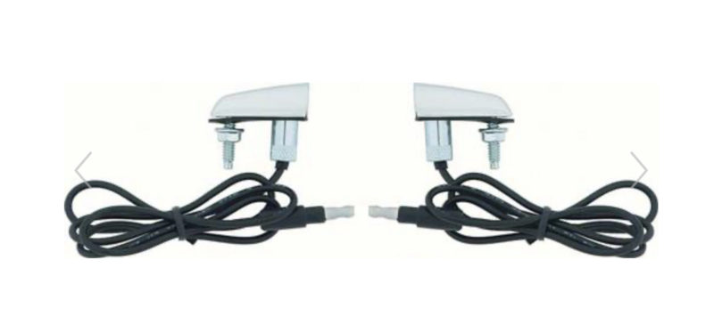

So Ive discovered that I need to replace one of my upper fender signal indicators. Upon looking around, the repos I see do not match what I have, they have a bolt that goes down through the fender and attaches with a nut, rather than a screw that goes down through the housing itself like in the picture.
My question is, before I order anything, is this the proper signal indicator for a 1970 Dart? If so, does anyone know of a vendor who supplies this indicator, or am I stuck with the repo or looking for a decent used one?
Thanks FABO
70-72 dart are the smaller ones

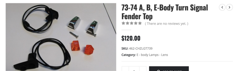

If the one you pictured is what is installed on your car, you'll have to replace with the same type which are 73+. The 73+ have larger mounting holes
Thanks for this, its very helpful.
So is the hole larger in the fender for the 73+, will the 70-72's not cover it completely?

I bought a 70 Dart with 73 indicators and once the 1970 repops appeared, I bought a set and installed them. That's been over 10 years ago and I had no trouble carefully covering the expanded 73 hole, but it is close.
If you need pics, ask...
