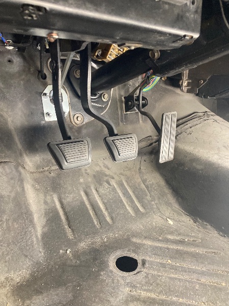

Anybody who is using the SST Hydraulic clutch kit I’m curious as to the height of the clutch pedal in relation to the brake pedal. Please post pictures if you have any.
Here is my 71 with the exact set up you are asking about.
Because there is a threaded adjustment you can change the pedal height... On mine the clutch & brake pedal natch...
Thank you. Just wanted to verify the pedal height.
The clutch pedal should come up and hit the travel limit bumper at the top of it's travel... Stock that bumper is higher than the brake pedal... On my car I adjusted the link so the pedal height matched the brake pedal then I swapped the stock fixed pedal travel bumper with a adjustable bumper... In my case I used a Ford hood bumper... Cheap & easy...
I just about run out of adjustment on the rod when I try to get the pedals to match up. It’s fine if I set the clutch pedal about 1/2” lower than the brake pedal. I’ll wait till I bleed it before I mess with it anymore (Don’t want to cycle it while it’s dry). Worse case if it bothers me I’ll get an adjustable brake rod
Tightened everything up a it’s not as bad as I thought it was going to be.

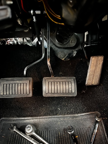

I have the silver sport hydraulic clutch and pedals are pretty even. Manual brakes and silver sport brake / clutch pedals. I used a reproduction clutch pedal rubber bumper from Brewers.

Not that I'm aware of... Pedals on most every manual trans car for the past 30+ years have been at the same height, there's no reason for them not to be at the same level so if it's easy to do why not?
I was doing it for the esthetics. I have a little OCD at times. What I noticed is that the master bottoms out before the pedal hits the floor. I wonder if there is an internal stop in the master or do you have to adjust the pedal to hit the floor before the master bottoms out. I’ll reach out to SST
