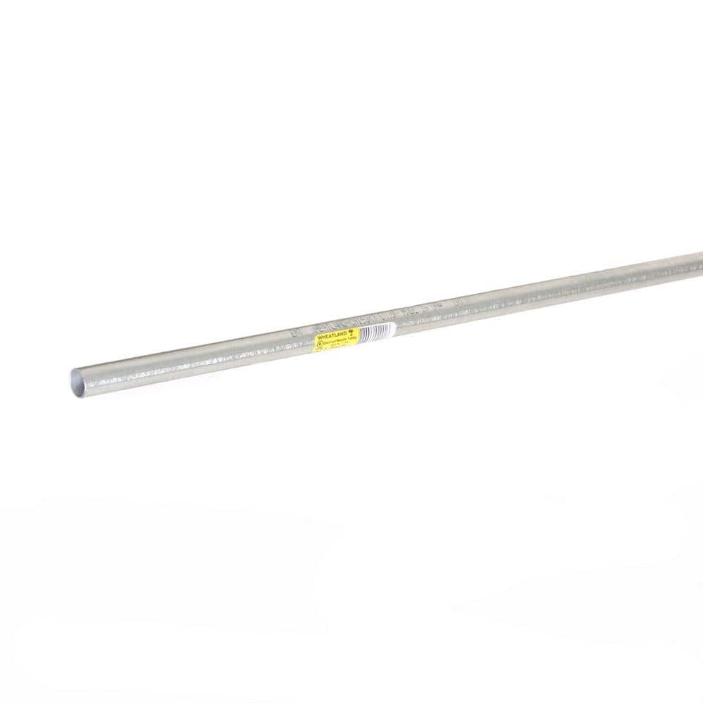

What did you use to compress the pipe so neatly
I have a big vice, one of those tools you buy that pays for itself a hundred times over. Also a protractor, and a metal chop saw. The chop saw cuts the ends nice and square, I just clean off the burrs with a file and wire wheel. I measured the angle from the firewall to the mount point and held the conduit in the vice at the angle measured and crushed it. Then marked and drilled the holes on the drill press, and used the vice to adjust the foot angles on the mounts to dial them in. I did form the foot (curved it) a bit to fit the contour of the tower. I painted it with VHT satin black epoxy and put a thin rubber washer under the foot to protect the body finish a bit when torqueing down.
