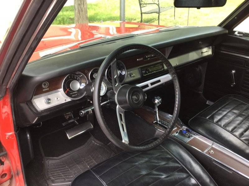

I ended up wussing out ( the car ended up taking longer than I planned and kid was anxious to have a ride), and just put slap stick in with standard shifter top plate. Works good though.

Whoever did the resto on mine years back put a B&M racchet shifter in when they added console. Since it is a cable shifter, it looks like any easy swap.
