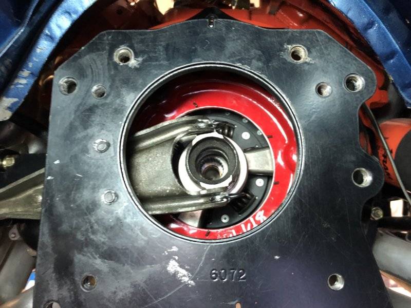

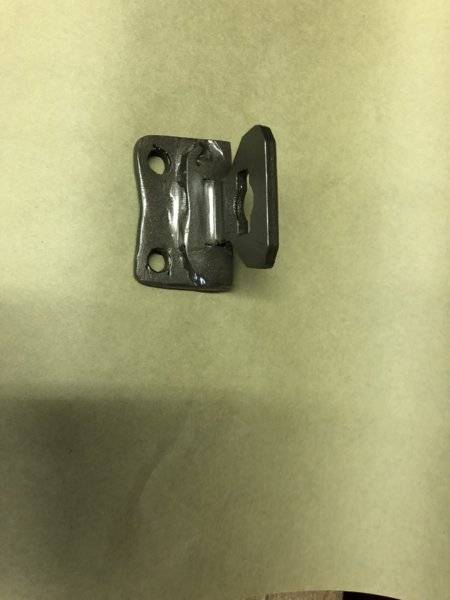

    After searching here I think I need to use a stock fork pivot

    That is what I used

    I tried using a stock one from early a and 68 and up they both do not work. The easy a fork bracket, the fork is in to far and up

    I will be using this setup soon. I'd like to see pictures of your bellhousing mounted ball stud bracket...No flexing issues with that one? Are you using the QuickTime supplied bracket?

    Mines a big block but may help? I used a quicktime Bell and the fork pivot would not work either, Wayne at brewers told me to try the b body fork pivot, and wouldn’t ya know it, that did the trick!

    I ended up using the one that came with it. 1/4 inch spacer and move the holes in.
