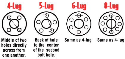

hey guys new to the page. im trying to buy new rims for my 1975 valiant duster! yes valiant duster. its Mexican. it has the front of a dart sport but back of a duster. its 225 stock and i dont know if its a small bolt pattern or big pls help
225 /6 should be small bolt pattern. The chart below will help you measure your wheels to be sure.
