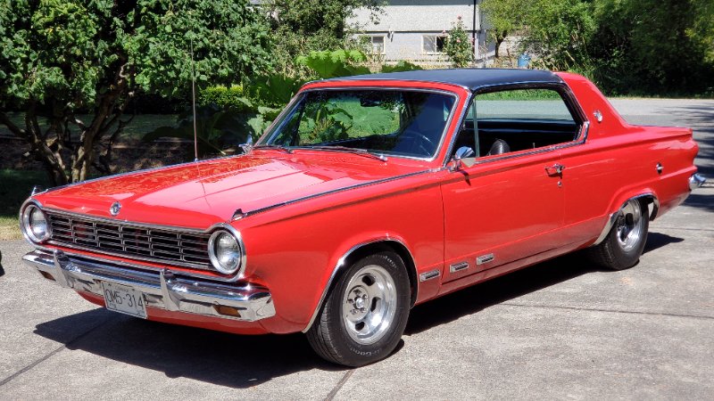

Is there such an adapter to change a small bolt pattern to fit wheels with a standard pattern. I would like a wider rim for a larger tire on my 65 Dart gt
Nice car.Is there such an adapter to change a small bolt pattern to fit wheels with a standard pattern. I would like a wider rim for a larger tire on my 65 Dart gt
sir. sir. that is clearly not a 340HOME | OGDEN | COYS WHEEL | OLDSCOOL WHEELS | HOT ROD WHEELS MUSCLE CAR WHEELS

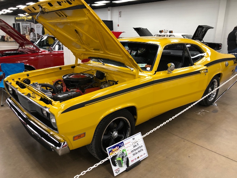

Coys wheels can fix you up with small bolt pattern wheels as wide as you want probably…. That’s what I have on my Duster with small bolt pattern
