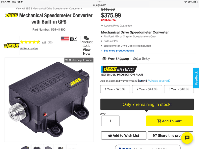

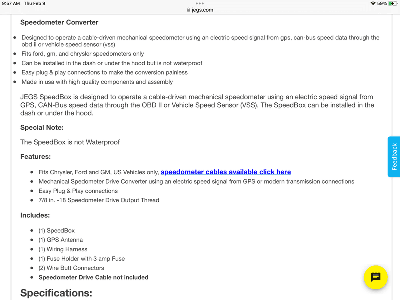

Convert it to a GPS converter and forget inaccuracries.
JEGS 41800: Mechanical Speedometer Converter with Built-in GPS - JEGS High Performance
I am not endorsing buying this from Jegs though.
