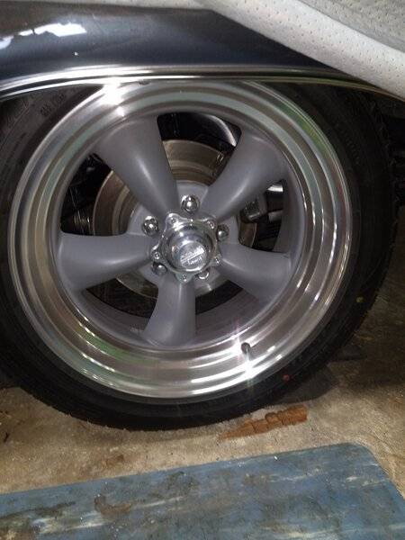

I have 245/45/17 on the back of my 66 without relocating the springs. They rub a little on the inside of the wheel house. I have about 3/8-1/2 inch clearance between the spring and the tire.
Even with the spring kit you'll probably need to mini tub to get a larger tire in there. The wheel houses aren't very big on the early A-bodies.
You can just see the slight rub mark
This is great info... looking at it closer I see what you mean about moving the springs and still needing to mini tub... @Greasyfingers for your Rim did you you have to do anything special for the back spacing?
They were just off the shelf American Racing wheels. I don't remember exactly what back spacing I used. It's been a few years since I purchased them. Definitely a 17x8 though.
