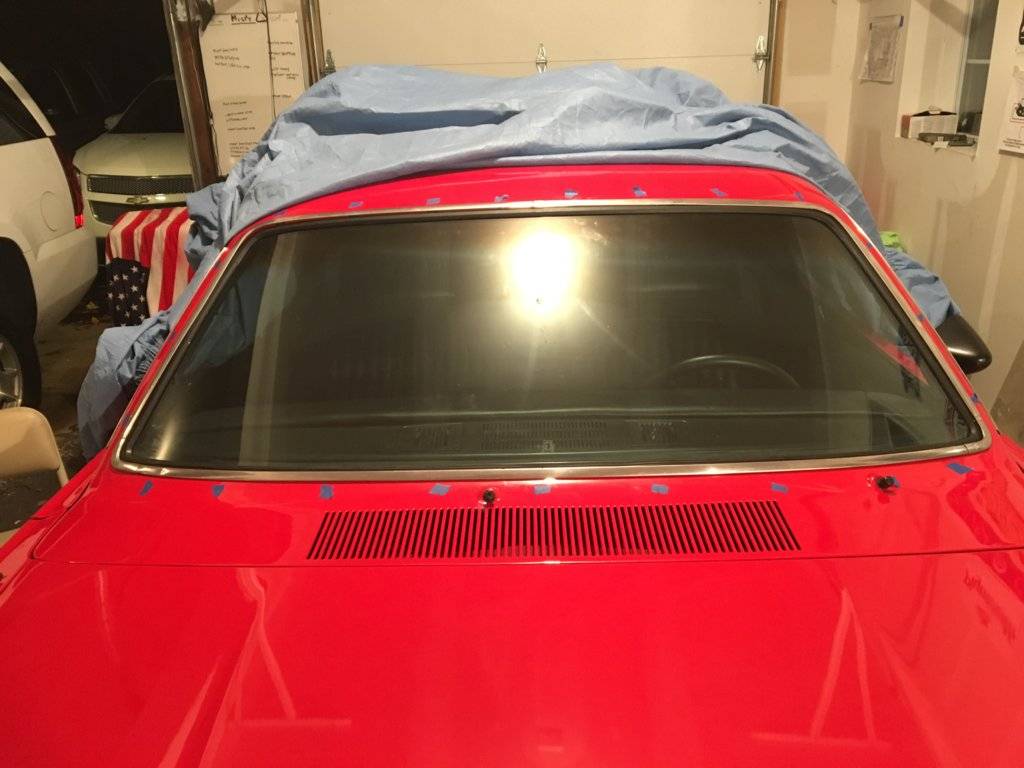

i have been avoiding this for months. I have a decent st of windshield trim and I tried snapping it in an the fit is so shocking bad a had to walk away from it for the night.
I need to now find the proper removal
Tool and try to figure what the hell is happening. New clips and glad gasket from Dante’s.
The clips for middle ones on the bottom are different from the outer ones are they not?
Yes the Center clips on the bottom are slightly larger. But the fitment issues are in the corners and the fact that the trim does not fit tight to the gasket

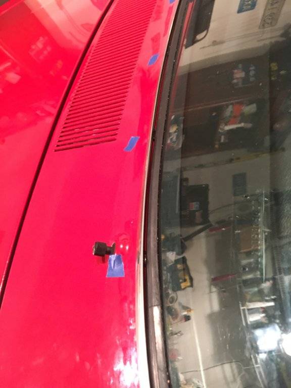

As you can see in this pic, the screws included are not stainless steel and they are more of a rounded head than the originals.
Going to get a trim removal tool, an assortment of clips and some new stainless steel screws.

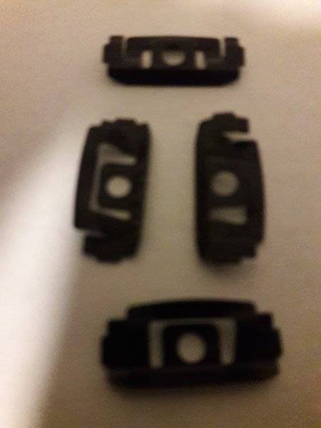

Some of the A-Bodies used a clip that I will post a picture of. Not exactly sure if they ran into the 70 year model run, but I have sold numerous of these clips for the 68 and 69 windshield clips. Do you happen to have an original clip that you could post a picture of?
I don't know how to post a photo but I can text one if you can give me a number.
The ones in your photo appear to look like it but the phots not to good
The car is an early 1970 built in december of 1969.
I tried to find the clips in you photo on your site & couldn't
I have just sent you my contact information that you can send the picture to.
