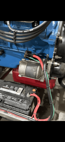

So, hooked up the old starter. Same result, rapid clicking, no crank. The article about low voltage got me thinking. I hooked up a multi meter to the battery and sure enough, its dropping to about 5 volts when I engage the starter. Going to run a ground directly to the starter and see if that solves the problem. Figures, adding an electric fuel pump this winter would compound into this long troubleshooting mess. It's really the old school Hooker headers that slow me down, I can't do anything around the engine with those things getting in the way. I'm really close to removing them and going back to an exhaust manifold.
FYI, Chinese solenoids are junk! They commonly fail because of the windings. If you ever have the chance to compare them to an American manufactured from the 60s, you’ll see a startling difference in the way they are wound. Most parts stores starters fail within six months of installation but a lucky few survive. We stopped using Chinese sourced solenoids in our restoration business and went back to the original Essex manufactured pieces. They are typically 50 yrs old or older but are bullet-proof.
I hooked up a ground directly to the starter. Still no crank. That left the battery. It's only 3 years old, still under warranty, so I never suspected it. It's always charged. I tested it with my battery tester and sure enough it's bad. Even though it was showing good voltage, it has no current. Should have done that right at the start. I think someone above mentioned that, never trust the battery even if it's new.
