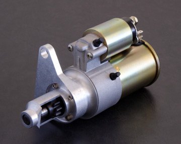

I tried the 2005-2008 Ram 1500 Hemi with manual starter. It's AWESOMELY COMPACT but hits the 360 block at the bulge for the bigger mains by a GOOD bit. I've been told it doesn't fit a 360 with a 904. Well it doesnt fit a 360 with a QT bell starter pocket either.
There is an even smaller starter from Robb MC. It's 360 clockable and possibly could work but only if the QT starter pocket isn't located the same as a 904, because he expressly states it wont work on a 360-904 combo (I'd be willing to bet it's the same issue as a 318/
360 magnum since they have same main sizes).
So is there anyone that has a QT bell and either a 904 or factory 130tooth LA bell that can compare the patterns to see if the starter pocket exactly matches either of them?

I know the denso bolts up to 727, 904, and 4 speed, but the hemi starter in the top picture wont clear a 360 block with a 904 bell. I'd bet the 904 starter pocket is rotated around the clock compared to an LA pattern 727, which i used to have.
my problem is the denso is chunky where the motor portion juts out and up from the block, which is were the swap recipient keeps it's steering box. The skinny hemi starter in the top pic has casting support of the solenoid that firmly hits the 360 block. If i cant find some type of info one way or another i'm gonna have to spend 400bux plus tax on a starter in the bottom pic, possibly just to send it right back, ugh

That would be awesome if you could do a tracing of the QT and a 904 or a small block 130 tooth factory bell. Ive gotten a response from QT (Holley) and they said the small block 4 speed QT RM6072 is, in fact, modeled after the 904 pocket, but he didnt swear that it's in the identical location. If it is, then it's basically a 904 and therefore a Denso, or possibly an adjustable (semi-clockable) Denso from Bouchillon are the smallest options for me.
If it matches the 904, then i'm sunk and have to move the steering box forward in the car.
If it matches the factory stick bell of a 130tooth, then it may work.
If it's somewhere else, just a bit lower than a 904 pattern then who knows, lol.
