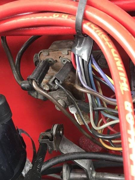

I have a 63 Plymouth Valiant which i switch over from a \6 to a v\8 and been trying to start it and all it does when i try to start it with the switch all it does is click but i can cross it over on the relay and it will start,Everything is brand new all but the ignition switch does anyone have any idea what it might be.Thanks for any help..

What color is the wire that goes to the relay i had 2 wire one was a pink looking and the other was black or dark blue and i just guessed on where they went could i have the wrong one plug to the relay i plug the other one to the horn relay.
On my 65 Dart the top right black wire comes off ignition switch.
