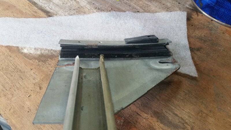

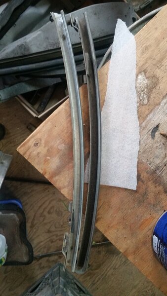

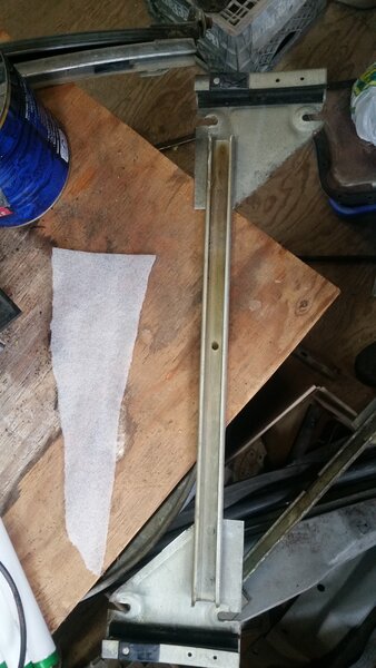

I'll grab a couple of more pics tomorrow. IIRC, There is a liner in each end of the the horizontal track that connects to the vertical tracks......I will check for sure.
The top bumpers (front and rear) are to limit the upward vertical travel of the window. The two "nipples" mounted to the glass contact them when the window is up.
The cat whiskers keep the glass from rattling inward/outward by centering it in the upper door frame.
Keep asking......I will reference anything that you need. :thumbsup:
Sorry about the delay......I got busy with my headliner. Feel free to give me a poke if I don't reply forthwith.
As you can see, nothing in the vertical tracks (just dirt in the right side track :)). Each end of the horizontal track has the liner as shown in the pics.
Anything else, feel free to reach out. :thumbsup:
BTW......Service manual says "lightly" lube the tracks that the plastic buttons and plastic roller ride in with Lubriplate. Nothing on the vertical tracks or the liners in the horizontal track.
