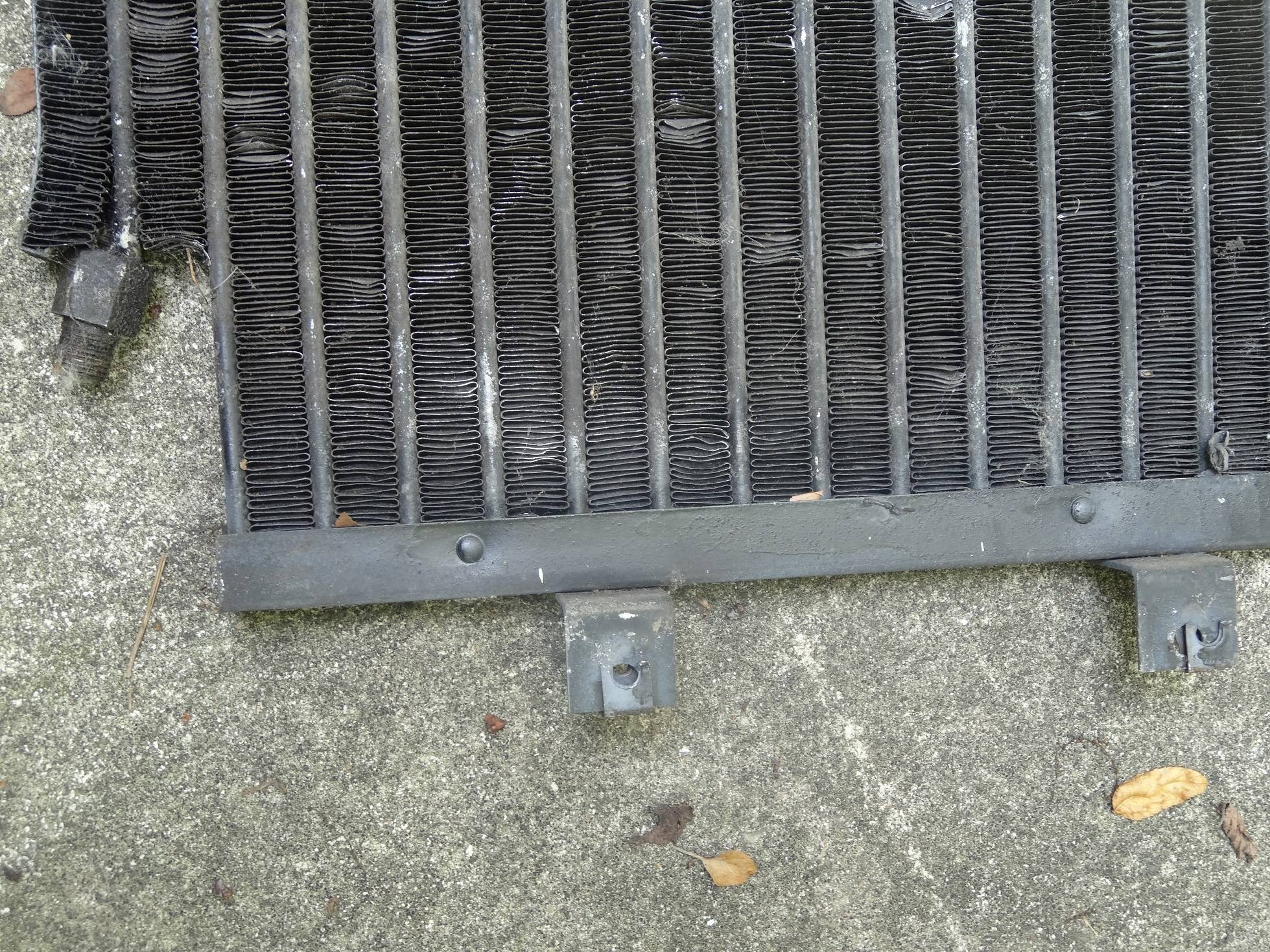

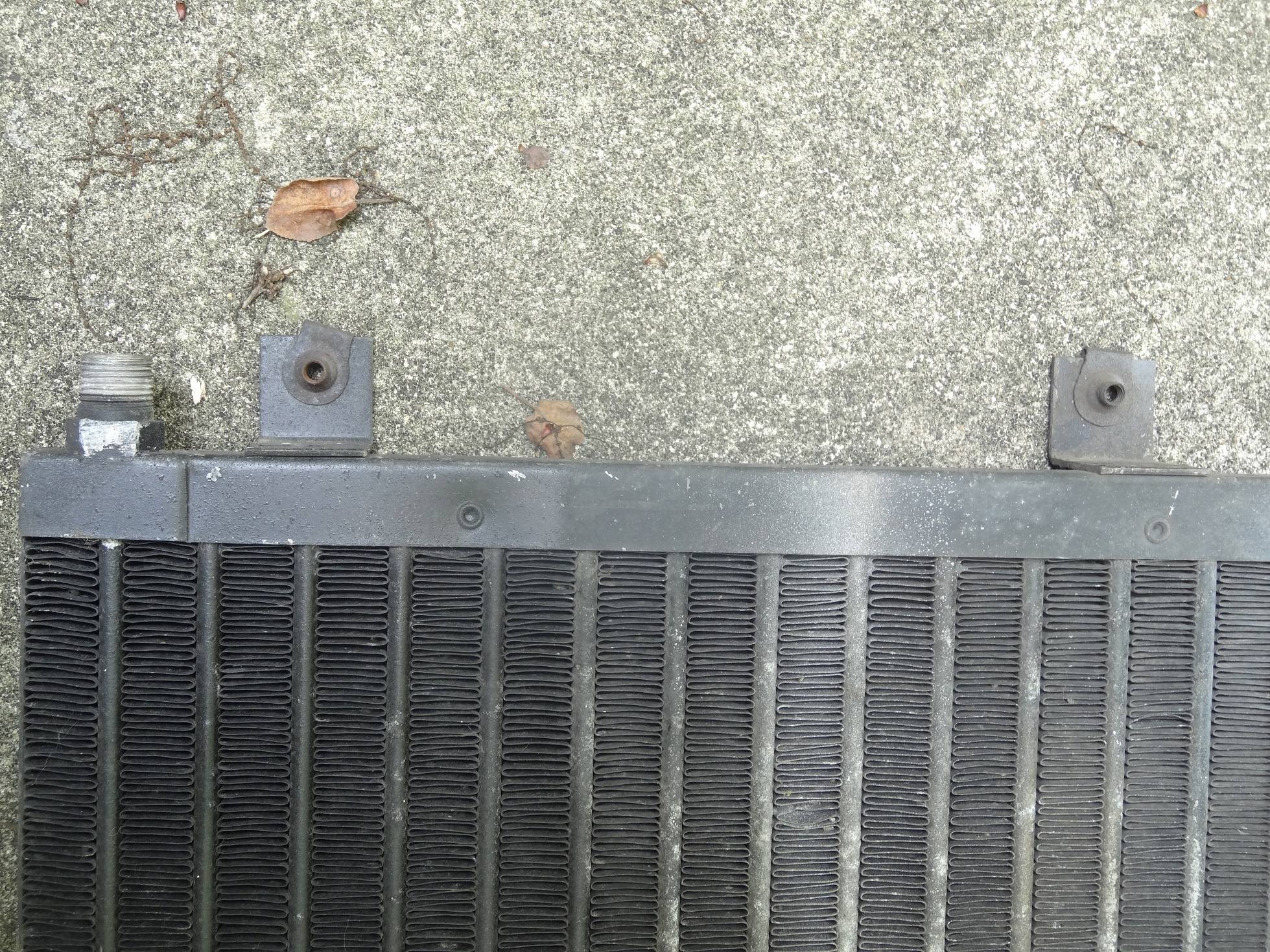

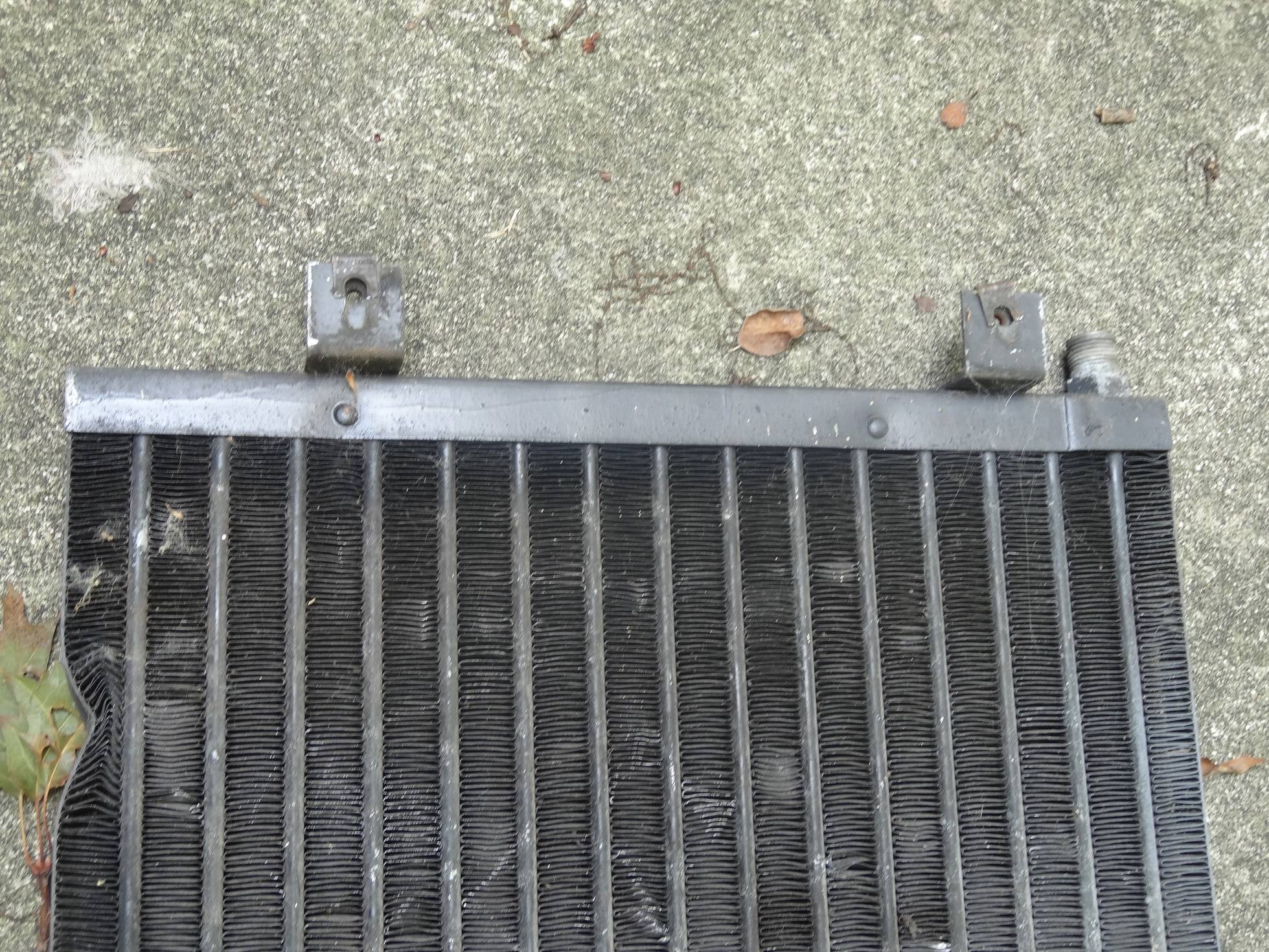

Here's some front and rear shots of the condenser out of the car showing the mounting points. See the square mounting feet and how the metal slip nut goes on them... They are closer together on one side than the other...
Front side:
Back side:

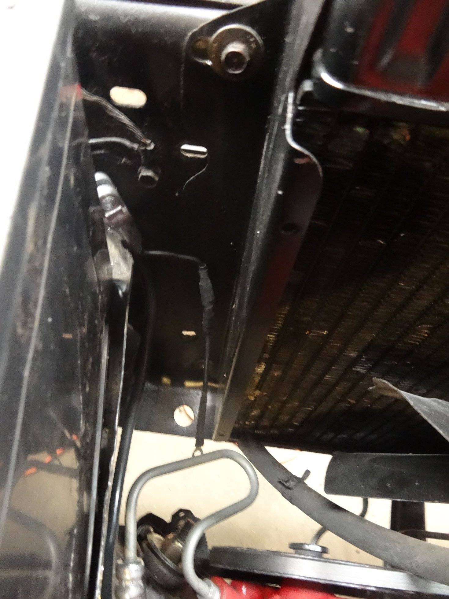

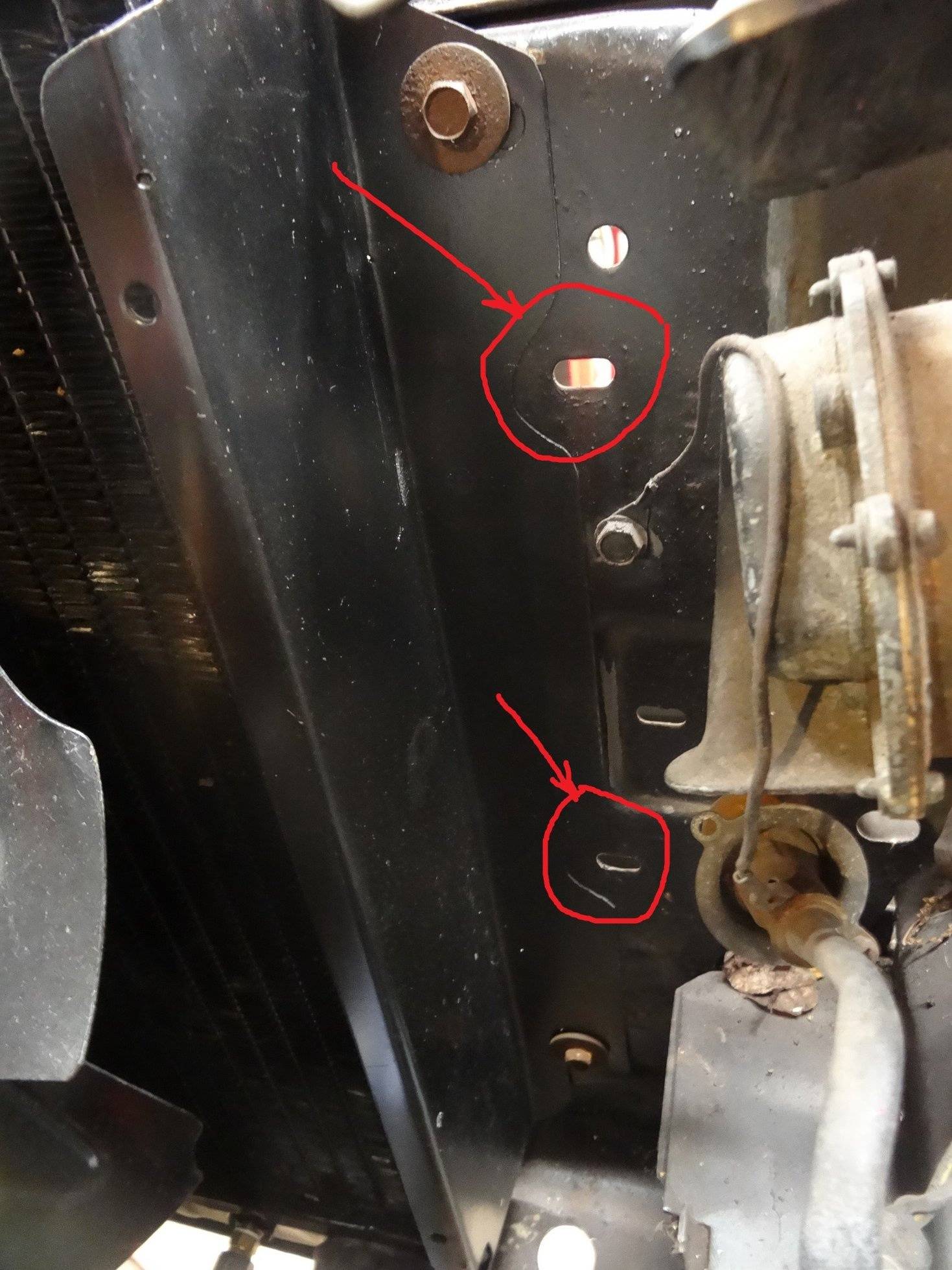

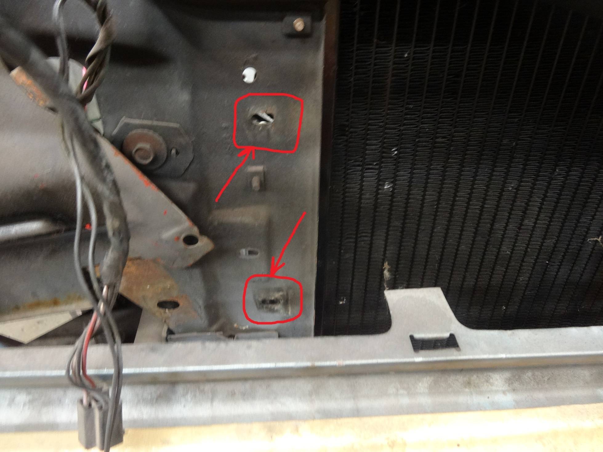

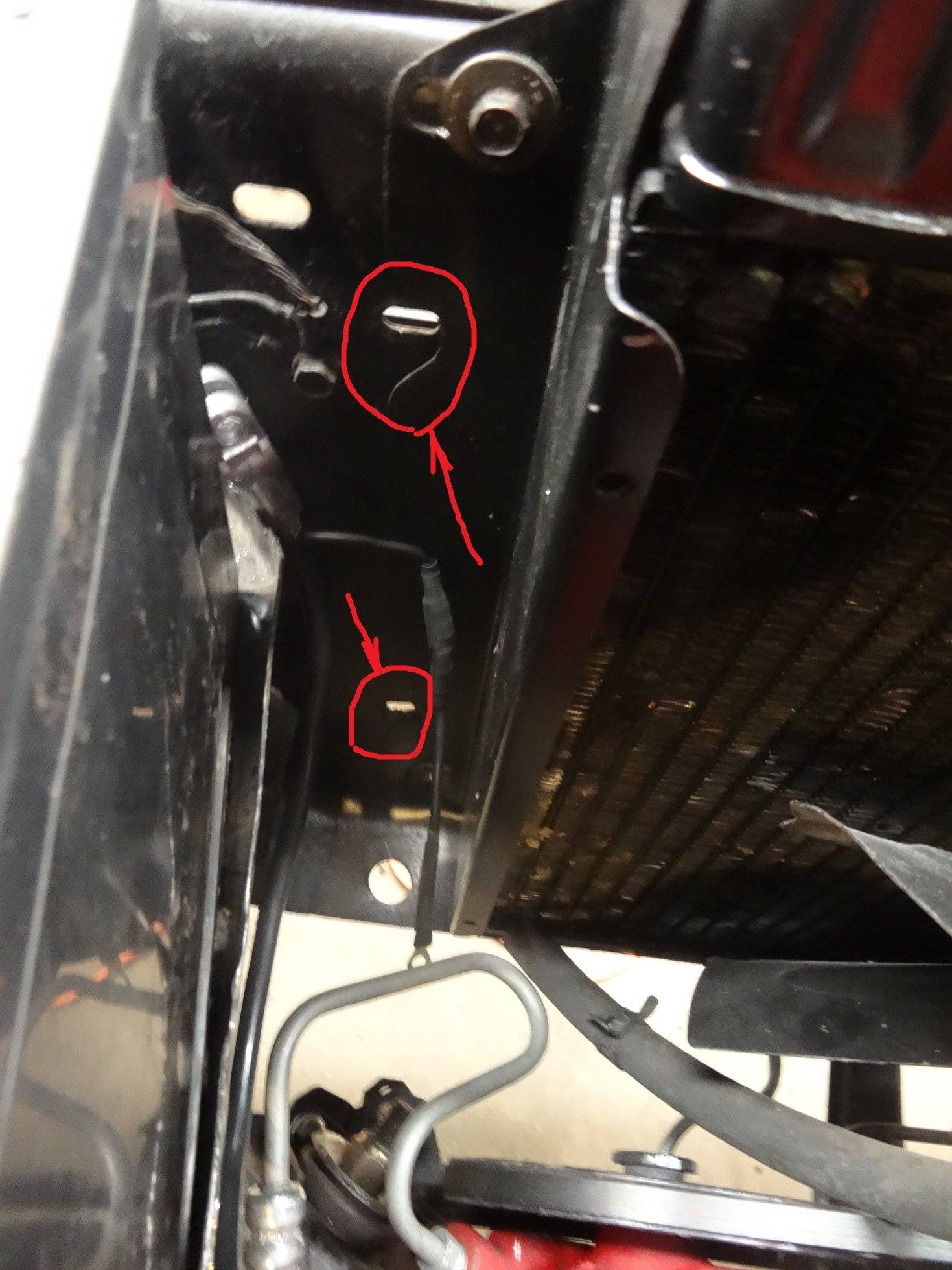

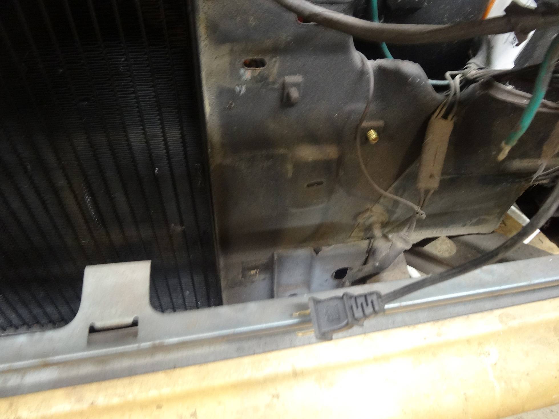

Here are shots of the 71 valiant that we took it out of. Notice how you can see the witness marks from the square feet from the front looking from the grille side... Then I show the back side from the radiator side to see where the bolts go in the sheet metal...
Pass side front:
Driver side front:
Pass side rear view:
Driver side rear view:
