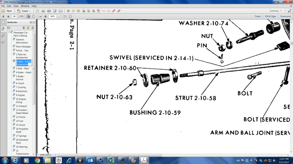

Which way, in the picture does the bushing go? #1 top rod or #2 bottom rod. I threw in the original rubber ones, they did not have a center steel bushing as in service manual.
Please add any installation procedure that you use. thanks

This 66 parts book shows the taper towards the LCA... so Yes , the upper pic.
As far as installations... only FSM tips are "lube and twist". ( words of wisdom in my opinion). I assume bushing in the frame first and rod after its set. I used the two piece Moog ones so I have nothing else to go by.
Get some anti sieze, lube the outside of the bushing, and squeeze into the K member. Top picture is correct. IMO those are the best bushings you can get for that location.

It can be pushed thru by hand. Is not too difficult IMO
Thanks for the help. It makes sense the tapered tip goes in first. I was over thinking the way it works. I see in 1968 manual the pointed bushing on a Valiant. I don't see how the originals did much, they were like hollow looking grease seals.
