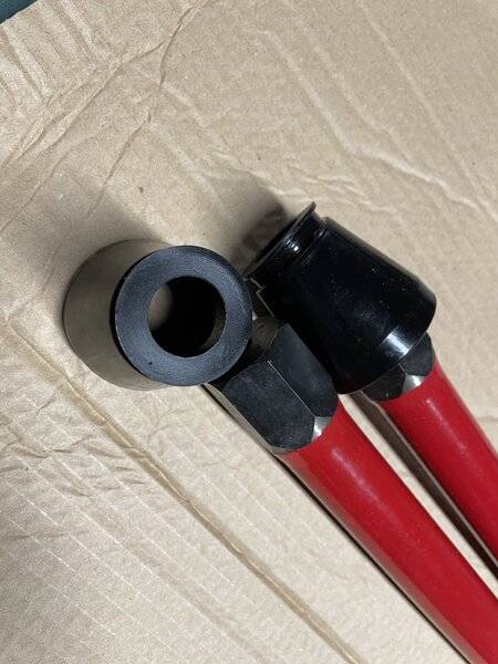

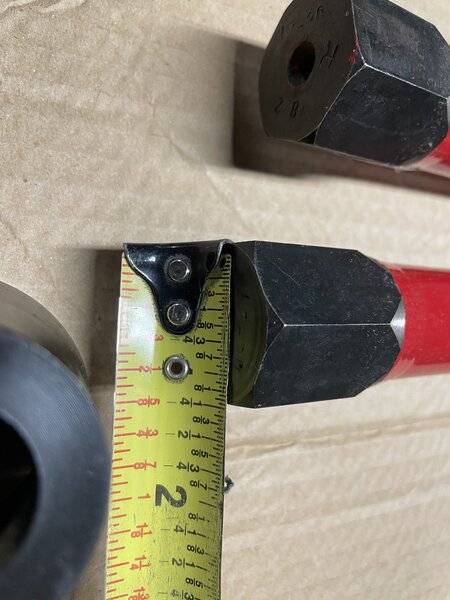

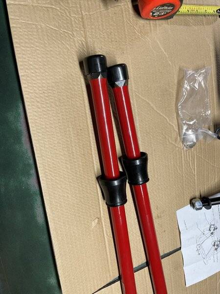

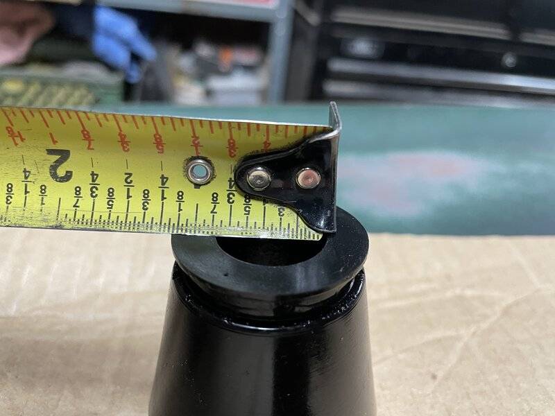

Anyone every successfully install these Poly Torsion Bar boots? I remember when I put the PST 1.03 bars on I tried everything but was unsuccessful.
Installing some Swa-A-Way bars and I just don’t see how it’s possible haha

Not a problem. Was able to install the bars with the boots on. Just slipped them through from the front of the car and then push them back forward into the control arms
Obviously, the boots are there to keep trash from entering the cup that holds the hex end of the bar. But, what if its just not used at all? If its such a PIA to put on, what if you just don't use it?
The sockets should be packed with grease after install. The boot is needed , OEM boots are good enough easy to install.

I bought a pair of boots and clips from Classic Industries that were made of a little bit softer rubber. They slipped on with the greatest of ease (along with a touch of petroleum jelly).
