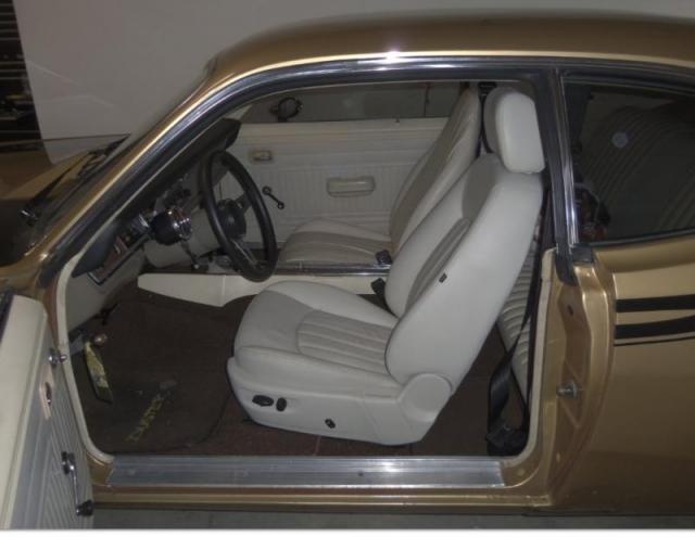

I have yet to see a set of Sebring seats that look anything like period correct or sporty. I have been wanting bucket seats for a long time, nothing is cheap when you are looking at B or A body seats, the recovering alone is going to run you at least 400.00 not including the seats and tracks. I really like the look of summits racing bucket seat, http://www.summitracing.com/parts/sum-g1159-2/overview/ But if I could ever find a set in good shape I would definitely go with the jaguar seat these 1998 era seats look like a new style A body seat, they look even better in black.
I could not find the thread, but there us a thread about these jaguar seats in an A body they look great!

I have these leather seats from a 90 Nissan or lexus I forgot which, they weigh practically nothing. Been in my Signet maybe 20 years both front and back seats. They fit a lot better than seen here...
These jaguar seats are the closest I have seen to a 70's feel look at them side by side.
