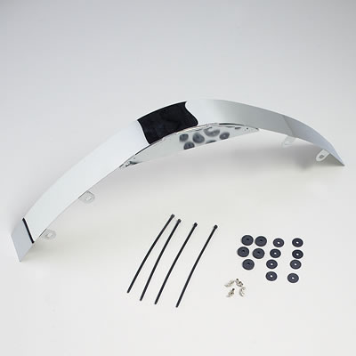

Summitracing.com
http://www.summitracing.com/search/Part-Type/Fan-Shrouds/?keyword=fan+shroud&kr=fan+shroud
